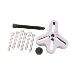

    Never pull on the outer ring on any harmonic balancer. Use the correct tool

    Yeah I looked all over for my "crows foot" puller but could not find it, I could actually see the outer ring was off about 1/8 inch already and looked crooked, the rubber crumbled apart when I got it off, just wondering if the one I have from the 1984 will work, also have one from a 1969 351w.

    Here's what I use to pull a harmonic balancer

    Yep, have one hiding in my shop somewhere, reminds me of a crows foot.
