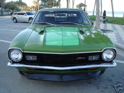

    Would one use the same semi-gloss on the hood hump or should it be gloss as the rest of the paint?
    I can tell the one in this photo is gloss, but I get the idea that some may use the semi. The grill will be a semi-gloss "bumper" paint.
    I don't know whose car this is, but I like it!

    I don't think the Maverick hoods ever got the "hump" painted black???
    The Grabbers were vinyl, were they not?
    I am pretty sure they were not gloss.
    Mustangs, Cougars, Ford hood scoops, and many other manufacturers cars got the same 'semi' black paint treatment on the hood. IMO that looks much better than gloss.

    1,388

    hahaha Power bulge..... Yes the 70 and early 71 had the dual stripes and even the 71 Grabber hood there was a split in the hood stripe that was between the dual scoops. Then the 72 was one solid patch of semi gloss/ semi flat or whatever its called
    Now I think that is the way they were.. I might have it backwards because you know now that I think about it I can't really remember if Dad's 72 had the split in the hood stripe or not... anyway here are the differences from 1970, 71 and 72.
    1970
    1971
    1972
    I might have the 71 and 72 backwards ???

    after checking my records I am almost positive that I have the 71 and 72 backwards in my above post.
  11. Craig Selvey
    18,336
    1,388
    You do have them backwards.
    1971 Stripe was painted
    1972 stripe was decal.
