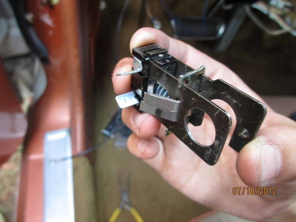

    On my red car the brake lights do not work. Do these cars have the switch under the pedal like an old ford pickup. Also any ideas or wiring diagrams would be appreciated. thanks

    Yes, same as the pickups. I had an '81 Ford truck and the brakelight switch was the same as my Maverick.

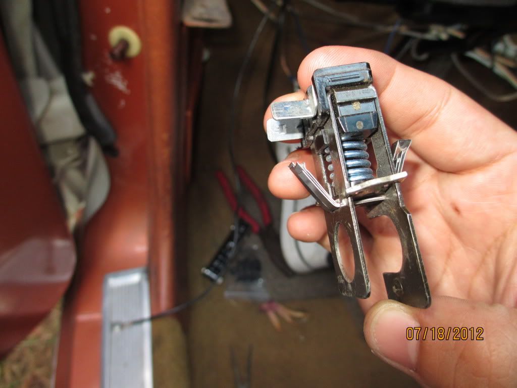

    Old Ford pickups had the switch on the master cylinder. :D
    The Maverick/Comet has the switch ON the front side of the brake pedal.

    just the pic I was looking for. thank you:thumbs2:

    turns out someone stole the brake light switch:mad:
