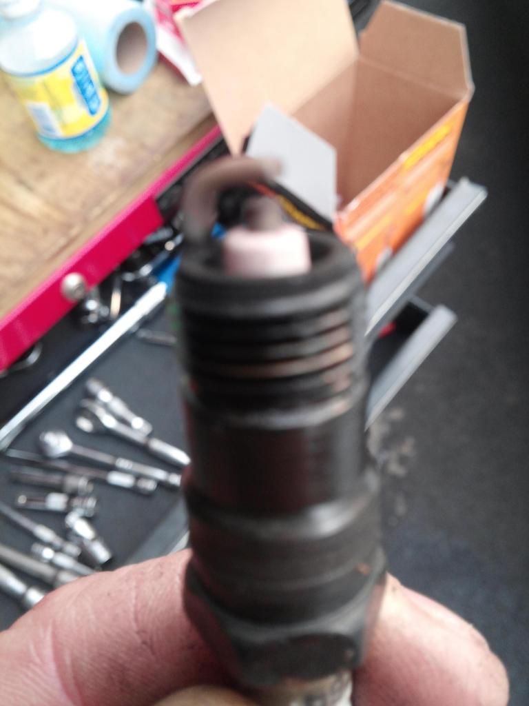

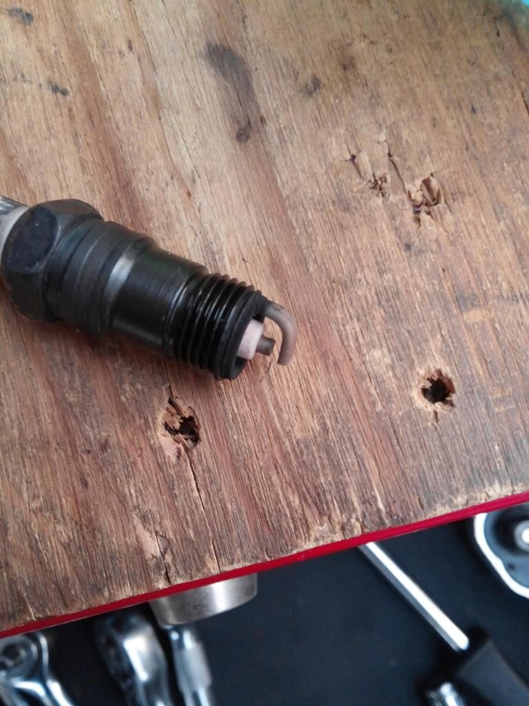

    Anyways so I thought it might be the plug wires as they were kind of crispy. Put new cap, rotor, plug wires, and checked all the plugs and regapped them.
    Porcelain on the plugs looks like its not even really getting fire at low rpm...

    My guess is dirty coolant.
    The plugs are fine, but look like they are running a little lean or hot.
