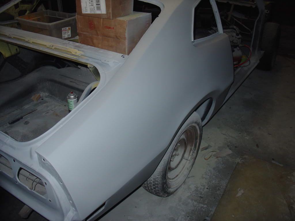

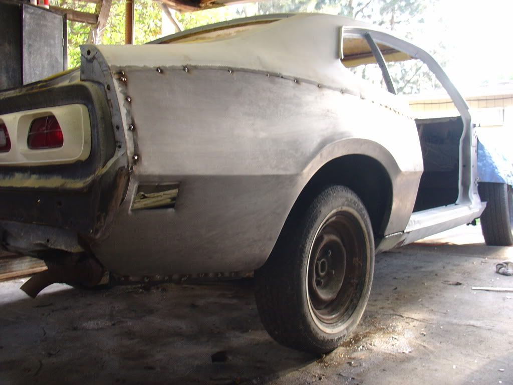

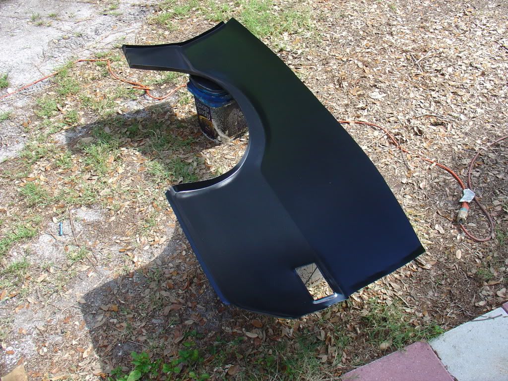

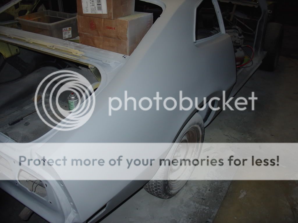

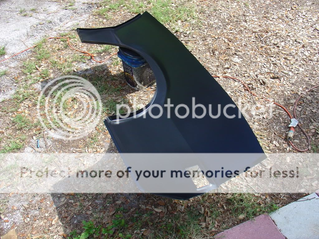

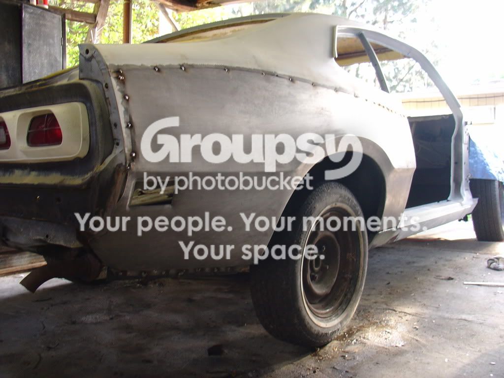

    I bought mine from American muscle 400$ for both sides included shipping. Here are the before and after photos and the stages I went through.

    Thanks for the pics! Great work!
    Dave, where is the difference? On the beltline?
