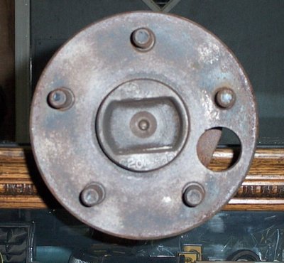

    [FONT=Arial,Helvetica][SIZE=+1]How to tell whether yours has a 28 or 31 spline axle.[/SIZE][/FONT]
    [FONT=Arial,Helvetica]This method works for pre-1971 axles, after that a few 31 splines[/FONT]
    [FONT=Arial,Helvetica]were produced with the concave oval in the center of the flange.[/FONT]
    [FONT=Arial,Helvetica]Therefore, the only foolproof way is to remove the axle and count.[/FONT]
    [FONT=Arial,Helvetica][SIZE=-1][/SIZE][/FONT]
    [FONT=Arial,Helvetica][SIZE=-1]Note all 8 inch units use 28 spline axles[/SIZE][/FONT]
    [FONT=Arial,Helvetica]28 Spline Axle[/FONT]
    [FONT=Arial,Helvetica]31 Spline Axle[/FONT]
    [FONT=Arial,Helvetica][SIZE=-1]Note the concave oval area[/SIZE][/FONT]
    [FONT=Arial,Helvetica][SIZE=-1]in center of axle flange.[/SIZE][/FONT]
    [FONT=Arial,Helvetica][SIZE=-1]Early 28 Spline axles are tapered.[/SIZE][/FONT][FONT=Arial,Helvetica][SIZE=-1]Counter sunk holes in center[/SIZE][/FONT]
    [FONT=Arial,Helvetica][SIZE=-1]indicate a 31 spline axle.[/SIZE][/FONT]
    [FONT=Arial,Helvetica][SIZE=-1]31 Spline axles are uniform in diameter.[/SIZE][/FONT]
