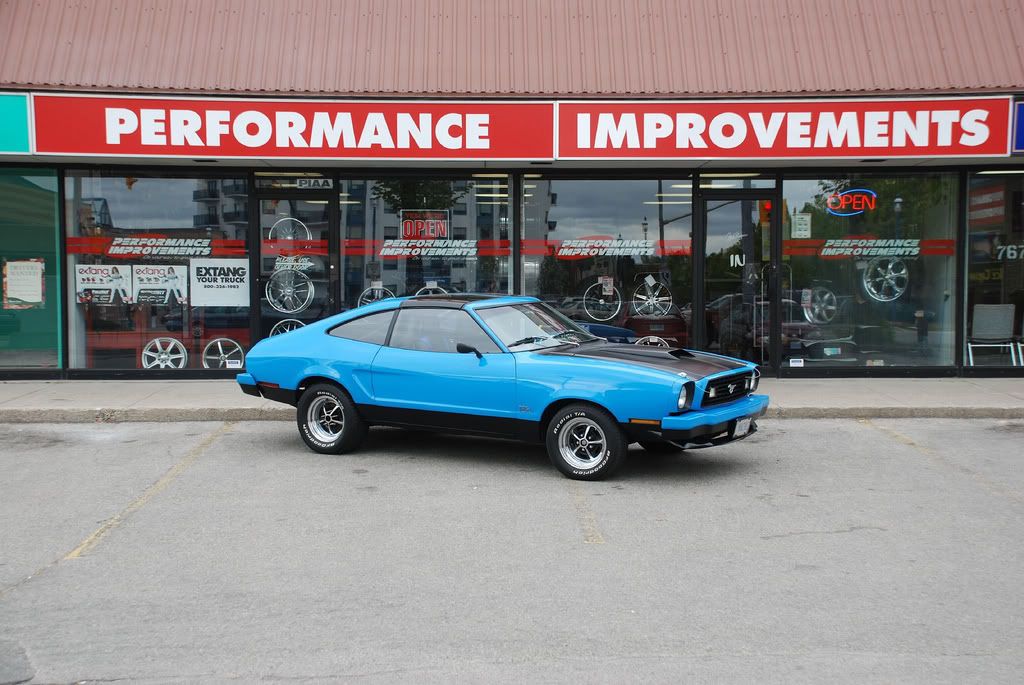

    I personally have the other Ford most people hate LOL

    That car looks great!
    I believe the hedman shorty headers will clear

    Love that MII (y)

    Thanks guys, for the Maverick header info and Mustang II :thumbs2:
    If anyone is wondering about My Mach 1 rollin' stock:
    Allstar Brand Brake kit (front) Granada Rotor / GM metric cailper. Re-drilled axles rear. 15x7" Wheel Vintiques Magnum 500's 225/60/14 front 245/60/14 rear BFG T/A's
