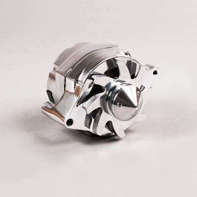

  13. rayzorsharp
    This is the same one as I have on my car...works great, very simple to install, hook up the battery wire and go. (y)
